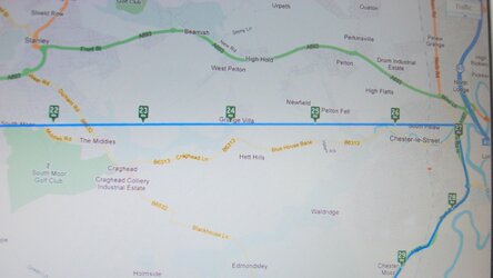

After this morning's trail ride, these are the figures that Cyclemeter ended up with and the figures pose several questions.
(RIDE TIME = 2.50.07) (STOPPED TIME = 13.08 Mins) (DISTANCE = 32.78 Miles)
(SPEED = 10.77) (AV.SPEED = 11.56) (FASTEST SPEED = 12.40)
(ASCENT = 1146FT) (DESCENT = 1078FT) (CALORIES = 4633)
1) (Distance = 32.78) The route I rode is actually 4 miles longer than the distance above (Memorymap OS 1:50000) but on checking the route map there are a few locations shown as being 'straightlined', the worst between 20 and 27 miles (see pic), where the actual route is further to the north and not straight. This explains the missing miles, but is it likely to be a signal or GPS shadow problem ?. Phone is in a thin pocket at the top of my Camelbak hydration rucsac. Am I going to have to get a waterproof bar mount ?
2) (Fastest speed = 12.40) On a couple of downhill road sections my computer briefly showed speed in excess of 30mph and there are a couple of long downhills on the trail where I maintained in excess of 20mph for a good couple of miles.
3) (Average speed = 11.56) 37 miles in 3 hours should be a tad over 12mph average.
4) (Stopped time = 13.08) Stopped for a couple of gates and to allow cars to pass before crossing roads. I didn't time the stops, but a guessing a max of 2 or 3 minutes. Does the system have a minimum speed where it classes anything below that as a stop ie, crawling past loose dogs, crossing roads etc.
5) (Calories = 4633) Really ?

1) Looks like there was a phone or GPS problem for a big chunk of the route. Its not something I've had and normally my phone is in my back jersey pocket. Is your phone the latest iOS with multitasking? Otherwise there are a number of things like txt messages, calls, pressing the Home button etc that can stop Cyclemeter. Also did you remember to lock the phone (button on top) before you put it in your back pack?
2) Were those downhill sections in the bit replaced with the straight line in which case they would not have registered.

Only some of the faster bits were in the 'straightline' section, the twice I hit 30 mph looks ok on the blue route and were early in the ride, en route to the trail.

Just had a thought on the calories - if the gps 'jumped' from one co-ordinate to another with a straight line, the software may have thought you travelled the distance within seconds, hence the huge calorie count. Check the splits per mile.
