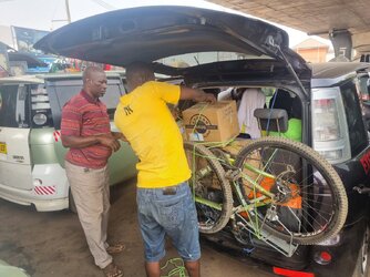

The Cube MTB did indeed do me well until a speeding taxi driver knocked me off it, early morning on an empty road in Kumasi, just by the prison! (My first crash/collision with a vehicle in 50 years of cycling.) Apart from a very bruised hand, several cuts and scrapes to my arms and legs, the front axle was slightly damaged, and the derailleur damaged that I couldn't use the higher gears.
