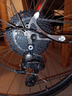

Neil_Merseyside says he's done this ?
You can and I have, just need a drop link to take the rear changer way from the biggest cog

its doesn't really matter as long as it Shimano/ Sram compatible & 11spd.
have a look at Airbike, they are pretty cheap and you can pick up the hanger extender you will need from them too.
https://airbike.uk/collections/11-speed-cassette
