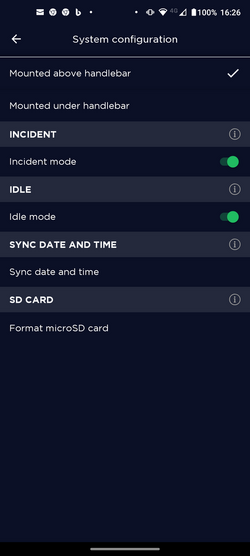

There is incident protection on the unit. Allegedly if the bike is tilted to 60 degrees for 5 seconds that file is locked to prevent overwriting.
Only one problem.....it doesn't work. I've lain my bike horizontal for over 2 minutes and nothing happens. More than once. Could be me; more investigation is needed.

It’s easier to test it off the bike!
I start mine up and then, after ten seconds or so, rotate it 90 degrees for ten seconds and check the file protection. It has always worked on my Fly12 (original model).
I just tried that. It didn't work.
What am I doing wrong?

Incident mode can be switched off. Here's a screenshot from the phone app for mine. Is yours on?
