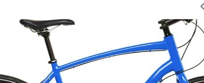

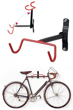

a little step back...The first storage solution I was considering was placing bicycle frame on hanger/ hooks like on the red hooks on photo in attachment.
that would do for me but my worry is next: cables for gears and brakes are right beneath main horizontal frame bar, so that means they would be the first in contact with hooks and carry the stress of hanging and manipulating the bike (photo 2).
I guess I shouldn't do that? honestly, I don't think it would ruin the cables but it could have some bad effect, couldn't it?
Or perhaps, dislocate the cables, could that be done easily?

Cycleops
Accra, Ghana
I wouldn't worry about the cables in contact with the hanger. Cables under the plastic are steel and not given to compression.
The only thing you need to make sure of is the wall is solid and not a stud wall as that might take the weight too well and the constant up and down.

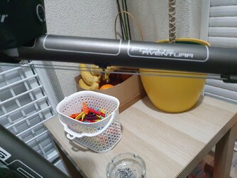

primarius
New Member
Here is the actual photo of cables. They are naked, tightened, 3 of them and about 1 cm distant from the bar. My concern was they would loose and damage but anyway I think it would not be a good idea to press them against bar with 15 kg g-force.
Cycleops
Accra, Ghana
Okay, so they run without any outer, that’s a bit different. They also seem to stand some way off the top tubes so you’d be pulling them a little. I still think you’d be okay but if you’re worried fashion a strip or strips of wood to fill in the gap so they don’t get stressed.
