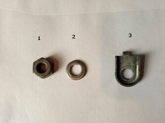

Whilst carrying my Brompton through a department store this afternoon I heard a noise and found that these three pieces had fallen from my Brompton. :eek:
In case you wondered, I think they are from the front wheel and were holding a stay (stay??) which has the clip on it that keeps the folded bike clipped to the frame. (I realise I may be using some of the right words but not necessarily in the right order!) :wacko:
If you have a minute to let me know which bit goes in which order and in which direction/side that would be great.

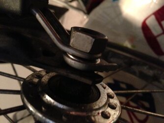

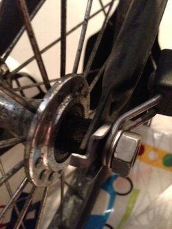

3,2,1 .....:smile:
Aha! Like this??
Thank you for the link - as clear as mud! Cycle Chat Peeps much, much more helpful!

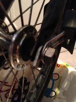

Fingers crossed this time it's right. Then I will tighten it with a spanner rather than by hand!
Big thanks!
Mice:hello:

In the right order, but spin the dished washer to fit the fork catch (3) before tightening.
