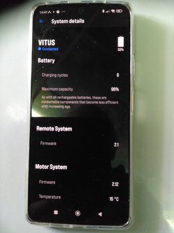

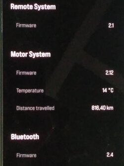

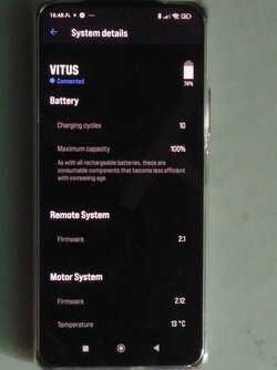

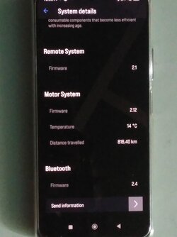

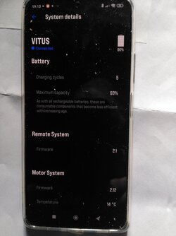

Hello everybody I feel abit of a traitor to be asking for HELP off people on this Boardman chat site
,I would have been a Boardman adv e owner but there was a sale on a Vitus Fazuapower bicycle 2021
model ,so I bought that one instead ,So what is my problem , I have found out like GZOOM did that I
need two battery ,no problem you would think , you can't buy a new one for love or money ,
so had to a look on eBay , there was a 3 day auction , so I ask if it had been look after , yes only showing 5 charges
from new , how had he stored it , he reply as Fazua advice for storage of their battery , he sent me a another
photo showing it charging so everything seems OK , but to be on the safe side I got in touch with Fazua , because
I was not happy in having to look at a used battery and this was was the old type 250 which you have switch on ,
I was advised as long as the battery was OK it would perform just as well as the 250x the only thing you have to
do is switch it on .So here lies the problem ,it a arrived late ,it was the day before the Bank holidays , well it didn't
look well look after , still I thought its whats under the bonnet that matters ,so fitted it and using Fazua app ,
it reads 5 charges but battery heath only 95% ,now I have done 500 miles and 10 charges and the battery heath is 100% ,
1 went a couple of miles on it then using Fazua app , it returned a reading of 5 charges battery heath this time 93%,
I discharge the battery to 7% then charge it up to 100% , it now showed 6 charges but battery heath this time 96%.
I am hoping that GZOOM will be reading this because I am sure he will have the answer , Fazua didn't tell me that the
250 is not a sealed battery like the250x , it got 8 screws fastening the cover on , and I can't find any tamper paint on
any of the screws .? Any help on the above would be a great help , PS Don't think this was a cheap eBay deal I paid
more for this battery than when it was new , if you remove the VAT at 20% . Any help on the above would be great .

@legitsan Not sure what you mean by paint on the screws, but on the battery packs I have the screws are painted over, though am not sure how tamper proof they are or if you could tell they have been opened.
For battery health, they do degrade (like all batteries), the older battery is currently at 94% health after 75 cycles, and the newer battery at 96% health after 28 cycles. Battery degradation is never linear, and in reality/usage I cannot tell any difference the range of either battery new compared to now.
I suspect the battery you have just hasn't been used for a while, or has some 'calendar' degradation - Most commercial battery cells will degrade a bit in usable life just from sitting there idle.
Essentially I wouldn't worry about it, battery degradation is a fact of life with any EV, as long as you can get replacement packs its fine though its worrying getting hold of a new pack from Fazua appears so hard.
For interest our EV (Car) battery has done roughly 290 cycles over 4.5 years, and its currently only showing 6-7% degradation. So the battery in these eBikes are clearly not the same quality/standard as the cells you find in EV car. It would be interesting to see if you could put in automotive grade cells into these packs as an DIY project, though probably not worth the effort or fire risk :smile:.

gzoom Thanks for your reply , I just be too busy with eBay ,all good in the end the battery has gone back . THE BATTERY past all tests , it was the seller description that was the problem , I wouldn't have bid that amount of money on a battery with that state of health ,below is parts of two emails from Fazua , The 8 screws hold the plate on the 250 battery ,but on my 250x its looked sealed with one screw at each end .​
Thank you for the fast reply and for sending me the diagnostic report.
All the the values in the report look okay and I couldn't find any problem.
The SoH (state of health) also depends somewhat on the age and storage of the battery, not just the number of charge cycles.
Since you have nought the used battery, it is very hard to say the details, but in the report looks all good.
SoH is only a rough guide and can therefore vary slightly in the app.
I hope this answer could help you.
I hope you have a nice week and please let me know if you have any additional questions.
Best regards,
Luka - FAZUA ServiceLuka Maksimovic 09.06.2022, 10:49
Thank you for the fast reply.
There is no anti tampering noticeable by the customer. The battery is sealed however, its housing has an integrated sealing - but besides the manufacturer there is no safe way to find out if the battery has been opened before
But from our experience after being opened one time it can be seen as the housing will not again close with a 100% fit, so you most likely would notice bigger gaps around the screws where the housing is fixated
