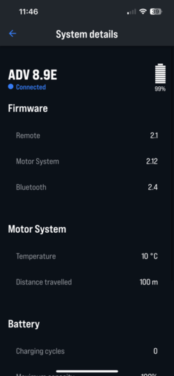

Just joined, thanks for everyone who has posted so far. Just received an ADV 8.9E as a commuter from tredz with a cyclescheme voucher.
Tredz were excellent and deliver was super fast. Surprisingly the bike has come with the latest firmware installed.
