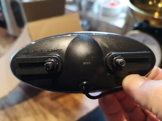

Thanks for the reply. They are the 720 read pannier and front basket fitting. Image attached. The width of the bolts can be moved between approx 6 and 10cm apart.

Yes - that is exactly what I want - but I'm a newbie and can't find a bracket to bolt onto the hole. I don't know what it's called so an probably going the wrong search terms. If you happen to know where I can pick one up, that would be very helpful!
