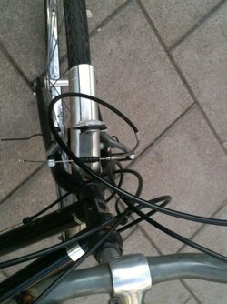

When she picked the bike up the front wheel would not rotate. I asked the same question - is it jammed? I asked her to take pictures - the one I will upload is less than I would have liked but shows the type of brake. She took the bike back today and she says the guy in the shop did something quickly to the brake and immediately it released the wheel so it was not buckled. What has really annoyed me is he then persuaded her that she needed a full bike check for £20! I am a professional engineer and I know all the usual brake designs and I don't think any of them should jam the wheel like this. It can only happen if the brake shoes rides over the rim onto the tyre which means it was not adjusted correctly in the first place. From the picture I guess this is what has happened on the RHS.

As I explained in a later post the guy in the bike shop made some adjustment and all was working again so there was no permanent damage. All I can think is that either the brake shoe had ridden over the rim. This can only happen if the brake shoe was adjusted to be too high. I cannot think of anything else.

That's a standard V brake, as you know, so enough power to lock the front wheel if applied sharply.
Did something happen to the brake as a result of the crash? If the shop guy did 'something quickly' that suggests to me that it's something like the noodle being dis-placed rather than the pads being re-aligned. Even a good mechanic will take a couple of minutes to re-align pads. TBH I think you're leaping to conclusions when you say that 'The brakes must have been installed incorrectly by the bike shop'. They may have been, but, IMO, you can't definitely state that from the information you have.

A thought has just popped into my head - you say the bike originally had a 'centre pull' brake, (by which I assume you mean a cantilever), which has been replaced by a V brake:
Was the brake lever replaced at the same time? When V brakes were introduced I seem to remember dire warnings about using them with levers designed for cantis.
To quote Sheldon:
'Direct-pull cantilevers (i.e. V brakes) have a very high mechanical advantage, which makes them unsuitable for use with conventional levers. If you do use conventional levers with direct-pull cantilevers, braking may be too abrupt"
As I say, just a thought.
