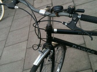

HI everyone. I really appreciate your help here. Managed to get another picture from daughter today. What do you think about the brake cable run?

Actually thinking about what you guys said about changing from a V brake to a side pull and not changing the lever. You are right - the pull on the brake cable per mm is going to move the pads in towards the rim more in the V brake than the cantilever. (I had no idea until now there was more than one type of brake lever.)
Not much wrong with that IMO . If you drop the cable off you can see if it is stiff in action in the sheath, and also you can move the levers on the fork legs to make sure they aren't partially seized.

Re running the cable from the left lever - can the brake be turned around the other way so as to keep the front brake on the RH lever??
+1
Ideally it looks as if the outer could do with being a liitle bit shorter, but it's OK as it is.
rualexander
The tops of the brake arms look to be rather far apart with a lot of bare cable between the rubber boot an the cable anchor bolt, maybe the washers on the pads need to be swapped around so that the narrow washer is on the inside which will bring the arms closer together. For a better cable run to the noodle pipe you can get a noodle with a tighter angle.
