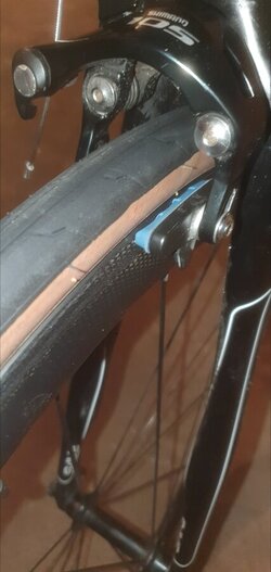

Here's the final picture does everyone think that an acceptable position for the pad

45 quid for the pair and they don't look a hell of a lot different from the 105s ...cheers
Just realised the fitting might not right though, these are the same but the other fitting type https://www.sjscycles.co.uk/brakes/black-tektro-r539-long-drop-caliper-brake-set/
For the better or worse ?
Likely for the worse. The arms will swing in that bit further and the holder will be a little higher as a result.
