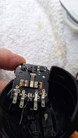

Does anyone know if I can jury rig this b&m lumotec lyt from a brompton to be in the on position.
The switch got knocked off.
The upside down T shaped piece of metal which dominates the board was the switches contact point

At present it's in the off position?
Solder a wire between the pieces either side which would make contact with the "T" piece, completing the circuit. Or between the "T" piece and one of those either side.
