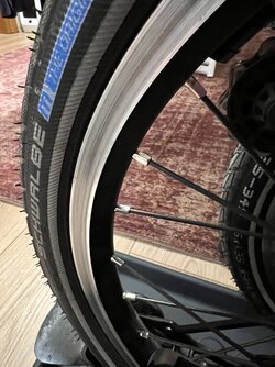

I have a couple of questions on switching my Brompton Folding Bike silver/wheel set out for black rimmed versions.
1. The sets tend to come in pairs - front / back wheel.
As my Brompton is 6 standard gears, (2019 superlight model) , can i get away with purchasing a 3 gear hub set or do i need to purchase one which states 6 gear hub ?
I'm a bit confused as i thought the 6 standard gears runs off a Sturmey Archer 3 speed hub.
My Brompton is a 2019 superlight
6 standard gears
h type
with mudguards / no luggage rack

1. Whats the view on spraying them black with car paint ? Or are folks preferences for the baked powder route ?
2. Which of those spoke bundles should i buy if i went this route ?
3. What did others think of the SJS cycles ready built rims , branded MiniMod which seem to qualify as the rear is listed as BWR which i now understand is what the standard 6 speed gears use ?
cheers - appreciated

Why not paint the current one to matte black? Could be an option as the black one is painted just the same by the factory. I’m pretty sure it will be cheaper than burying a new hub.
They didn’t have black cable guard on stock so I bought silver one and painted it. Worked just fine.

Do you think the brake pads / does the brake pad rub off the black colour on a rim be it DIY or even bought from SJS cycles ? Or are multi coloured rims normal these days and surivive brake-block wear ?
CEBEP
Thanks folks -
Brake pads side of the black rim is not painted.
