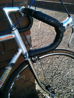

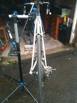

Well I'm pleased to report that it worked!
