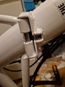

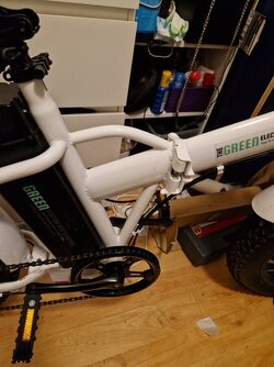

I've been cycling for about a month so I my questions will be very stupid.
A piece broke off my bike. I don't know what it's called so I don't know how to look for shops that can fix it.
It's a folding ebike and it can't fold now because the thing fell off. It's like a quick release folding bracket?
Also, I put the battery back in incorrectly and now it's stuck and not holding it's charged as well because it's not seated correctly.
Are these things any bike shop can fix, or do I need a specialist ebike shop?

I suggest you contact the seller and find out what their advice is. They may be able to supply you with the missing part which looks like a clamp which locks the hinge in place. They might also be able to help with the battery issue.
If bought second hand you could search the internet for help or enquire of a bike shop that specialises in such bikes.

The hinges on these bikes are pretty much universal I think so one from another make may fit, that or look for a scrap or very cheap similar bike.
The battery issue is something else where the seller might be the only one that could help, but similarly the battery could be used by other makes if yours is kaput.

Update: My housemate found the metal piece minus the nut to hold it in. But I can consult the oracle (google) to get his back on.
The bike is still usable it just doesn't fold and the battery need to be charged more often.

That's complete, the ' nut' (I think) is on the left, if it is threaded. You insert the QR with the spring and close the hinge. Tighten the adjustment nut so that you can close it without too much effort. It shouldn't be too tight to close that you might stress the metal pin, if you understand what I mean. You'll get the idea when you try.
Works in the same way as a seat bolt clamp.
i beg to differ :smile:

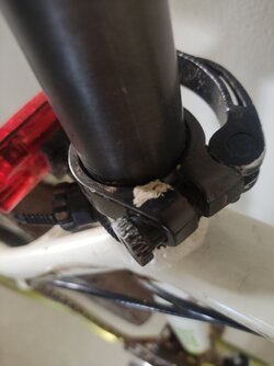

the nut part is still missing , its like a quick relesse bit thats your looking at as i have a seatpost that has a similar design , something like this

Thanks cyberknight that's exactly what's missing except it looked more like a traditional nut.
that bit on the end of the bolt is still in your frame on the piccie, i reckon you can put it together, if you think you need another nut anything compatible should fit ,Any local hardware store or bike shop should have something to fit
