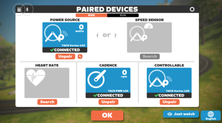

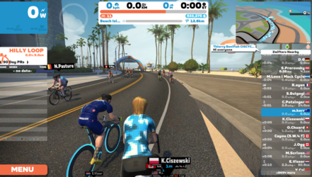

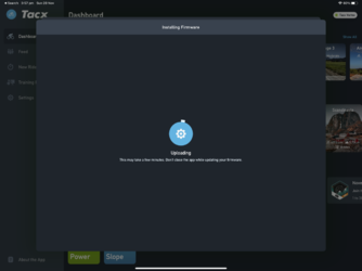

Hi. Hoping someone can help me. For a few years I used Zwift successfully with my Tacx Vortex Smart trainer. It always connected quickly and easily. For the last 2 years I haven't used it as I've had complications from a broken leg. I'm now cleared to go back to Zwift. I turned on the trainer and downloaded the latest version of Zwift. The trainer connected and I chose a ride. My avatar appeared on the track as did my name in the side bar which features everyone currently riding. But when I pedal, my avatar doesn't move and no info from the trainer appears. I looked down at the light on the trainer and seeing it was red downloaded the latest Tacx (now Garmin) app. My trainer connected with it and I saw I needed an update. I clicked update and waited. And waited. And waited. After about an hour approx 3% appeared to have downloaded. Same after 2 hours. I have spent this evening deleting and reloading apps. I have tried 4 different devices - 2 laptops, an iPhone and an iPad and have had zero luck. My trainer connects via an ANT dongle. Does anyone have any idea what might be going on? I can't work out any other ways to make it work. Thanks for any help you can give me. Cheers, Mel. Please see screenshots attached.

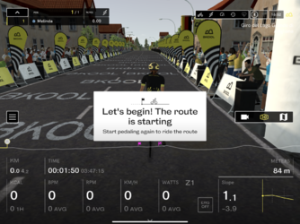

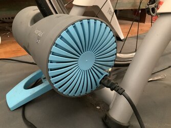

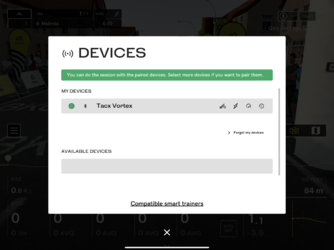

I have tried with the Tacx app on my iPad. It finds the trainer but just won’t update. I have downloaded and tried with BKOOL. It also recognises the trainer but the avatar doesn’t move when I spin the wheels. The light on the vortex remains solid amber the whole time. This is rather depressing!
