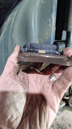

Another job. 17 Polo rear brakes worn out.
First job, get the seized wheels off the hubs, took large block of wood and sledge hammer to break the corrosion bond. Wheels obviously haven't been off in years.
Then onto strip down
Clean up hub
Found this, so new shocks going on too
Pads and disc shot
Reassembly today then oil change

Best to do them earlier, just incase the material wears down to nothing and then discs will be trashed, if they aren't already (due for replacement)
