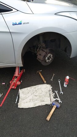

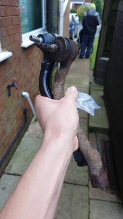

Went to visit the old man today and decided to take advantage of his drive and tools and able (ancient) assistance (in passing all the wrong tools) to change one of the track rod ends that was highlighted on the MOT in March and had developed into a knock.
Genuine part came in at £20.34 so wasn't worth faffing with the unknown nobranders. Was also handy that it was exactly the same size so could count the turns off and count the turns on to keep the tracking something like.
As usual all the tricky bits went fine and the easy bits turned (nice big accessable nut) turned out to be a PITA as did the wheel nuts that had been seemingly done up with a windygun for trucks. Why don't people but a bit of copper slip on the hub mating face to stop alloys sticking? Seems I need to buy a new size of single hex socket for the nuts on this car.
I'll get the other side when its in stock. Then get the tracking done and the ditchfinders swapped off.
And how the hell can the main stealers justify £10 per wheel nut!
