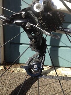

Can any identify from the picture what the largest cassette I can fit using the current set up
It's currently 11-25 and I would like a more Hill friendly set up
Many thanks
Stephen
It's a short cage mech, so it may cope with up to 28..

According to the information I can find, the Rival will accept sprockets up to 27T, so your 11-25T should be fine.

Thanks brommyboy, I was hoping to fit a 11-28 ultegra cassette though :sad:
Shift onto the largest cog at the back. For every 2mm clearance between the top jockey and the largest cog an additional tooth would fit. Since you have a 25T you are looking for more than 6mm clearance. If it is not there adjusting the B screw will help. The chance of a 27T spec mech not being able to take 28T is very small.
You would need a new, longer chain too.
