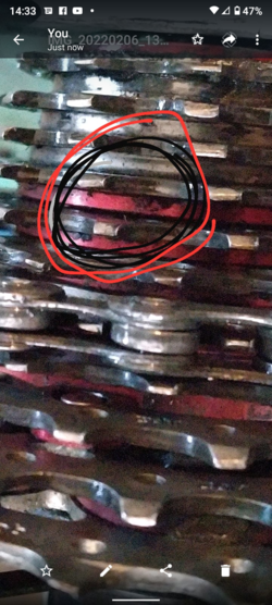

There....The spacers also appear to have a gap between them and the adjacent cogs or is that an optical illusion ?
I have just had another look myself I agree there might be an I'll fitting spacer or two there I'll double check and reassemble

spacer added and cassette reassembled
Moving away from microwaves (is that to obliterate data on the cassettes?), What was the error the OP 'found'? A missed spacer? How could adding a spacer move the cassette away from the dropout. Sorry to be dense: help me here.Given the OP has found his error
I couldn't quite understand that either.How could adding a spacer move the cassette away from the dropout. Sorry to be dense: help me here.
It's an 11 speed cassette.
The locking screw for the cassette was rubbing against the chain stay drop outs and tiny spacer in the freehub central axel locking nut moved the whole free hub and cassette a couple of mm away from the dropout and the point of fix for the whole rear axel is now centred on the central axelMoving away from microwaves (is that to obliterate data on the cassettes?), What was the error the OP 'found'? A missed spacer? How could adding a spacer move the cassette away from the dropout. Sorry to be dense: help me here.
