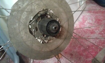

It surprises me too, thanks for the link. I will post a pic, I guess my worry as I dont know the working of the hub etc is that I might misdiagnose it. Maybe a clean would fix it even but I cant see a way to open it up. I can see a possible way but the spanners in my bike toolbox dont go to that size, they stop at 16 and I think I need 17

Dont think its the chain, when I use the cassette remover to tighten the cassette on, the cassette is able turn the wrong way.

Picture of the offending wheel

I agree it looks like any other Shimano freehub, but the body will do if it's Shimano compatible. If you strip down where the arrow points you should find the free hub will just pull off. If not then it will either be secured from the back with an allen bolt, or be fully threaded, but the one below seems to be the most common nowadays.
Aha, thanks, where your arrow points is slightly too big for the hub cone spanners I have, which is I think the tool I need to use?
On the outer nut you should be able to get away with a 17mm open ended spanner, or even, whisper...an adjustable spanner:blush:
ok ok Im not THAT clueless, to my eternal shame I don't have one of those at the mo, my last one broke and I havent replaced it :blush:
