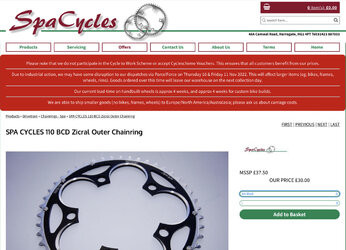

If 5 bolts then this will be suitable (available in both black and silver);
https://www.spacycles.co.uk/m8b0s210p3054/SPA-CYCLES-110-BCD-Zicral-Outer-Chainring
