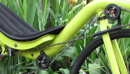

To Furai owners, did any of you replace the idlers with Terracyle idlers/if so were they worth it?
I've been chasing Pat at Terracycle on the development of these idlers since purchasing the Furai without them. The main issues with the stock idlers (as shipped at the start of this year) are:
1. The Power Side chainkeeper does not work well.
2. The Power Side idler does not float.
3. The power side chain likes to gnaw on the mid return idler, the fork, and sometimes snags the return chain at the crossovers.
4. The front return idler breaks, and could use a chainkeeper.
Challenge have issued me replacement idlers, and the newer/upgraded in-house versions address point 4.
I'm a couple of weeks of getting the Terracycle kit now. Its not an essential upgrade, but it does sort out a lot of niggles. I can share pics if you want. You can ride a long way on a broken idler, but its not great.

I just sent an e-mail to Terracycle about an idler kit for the Furai because I didn't see one on their site. I hope they do offer because I cannot accept paying four grand for a bike that breaks.
I can save you some of the wait.

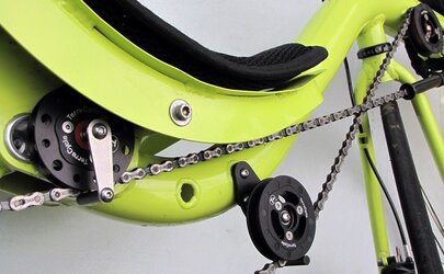

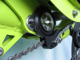

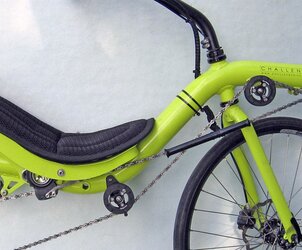

Terracycle purchased a Furai a couple years ago and have developed idler kits for it. They're just not quite ready with all the accompanying PR and instructions. They make two different versions. Both include return idlers, but one retains the original Challenge power side idler. This version provides a new, very stern chainkeeper mechanism to keep the chain under control at all times. This is usually the big complaint with that idler. They are actually selling the new keeper to Challenge now. The second version replaces the stock power side idler with a TerraCycle idler on a new floating mount.
Attached are photos of the version that retains the stock power side idler. This is mostly intended for things like the Mistral where the stock idler is integrated into the suspension pivot and it's too hard to replace it with anything else (see attachment id_FuraiSide5a.jpg, id_Furai_stockPowerClose.jpg).
Also attached are photos of the version that replaces all the idlers (see ip_furai3_lo.jpg, ip_furai4.jpg). The power side idler has about 12mm of float.
On both kits, the mid return idler is moved down on a special mount to get it below and out of the way of the power side chain. A small piece of floating chain tube is used to protect the fork where the power side chain goes by. Since the tube is made from a quiet plastic and attached via a special floating mount, it is very quiet. You basically can't hear it.
As above, they haven't announced these kits yet. They've been mechanically complete for a couple months now, but Pat's been too busy to do the instructions, the website, and a press release. They have already sold the chainkeepers to Challenge and a couple of kits to Fujin customers that didn't want to wait. I've asked for pricing to get the full kit to the UK.
Andy.

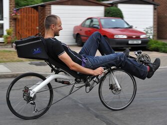

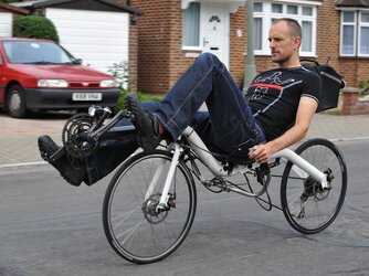

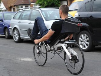

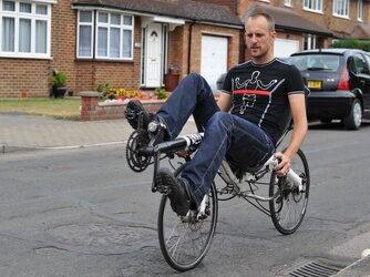

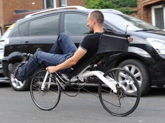

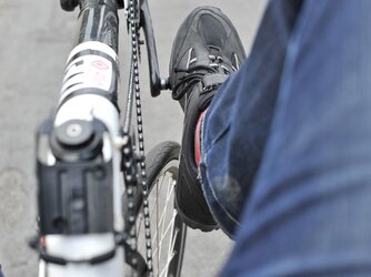

Do any of you have pictures of yourself on the Furai with USS? The Challenge site has some OSS pics but I want to see the seat/arm/leg intergace.
Here you go, courtesy of the wife today. Two flybys, one left to right, one right to left, one race with the toddler, and one demonstration of heelstrike from the driver's eye.
Andy.
frontquarter.jpg frontquarterclose.jpg frontslow.jpg interference.jpg rearquarter.jpg rearquarterclose.jpg sideon.jpg

Thanks! Awesome pics. Did the toddler win? Ha! I have a 2 yr/7mo old daughter myself. I see that from one pick on the side it looks as if you culdn't do a left or right turn with out hitting your calf. It is a beautiful bike btw. Is heel strike an issue much for you now? I am aware that once underway that heel strike will go away but there are times when you have to go slow and turn. Is it something you overlook or does it bother you still? It seems like Challenge could have put the cranks higher and the front wheel alittle further back to help this some. Again, awesome pics, beautiful bike too and it really helps to see someone on a bike to get a feel of what it would be like to ride it.
arallsopp
Post of The Year 2009 winner
Bromley, Kent
He won the first loop, yes. He turns tighter than me. :biggrin:
I see that from one pick on the side it looks as if you culdn't do a left or right turn with out hitting your calf. Is heel strike an issue much for you now? I am aware that once underway that heel strike will go away but there are times when you have to go slow and turn. Is it something you overlook or does it bother you still?
In loose jeans, I suspect I could rub the fabric on the wheel if I tried. The calf would be out of reach though. Worth saying that either end of those flybys terminated with a 180 degree turn in the road (which between parked cars is maybe a lane and a half in width), and that I didn't get any interference from the wheel/pedal/clothes.
Turning at less than 3mph invites it, but then, at that speed, I'm damn close to falling off anyway :smile: Learn to pull away straight, and you don't encounter it. I really don't think about it any more, and instinctively roll through low speed turns with the inside leg raised. Cleats help, because they put your foot in an EXACT position. This way, you very quickly learn where the contact will begin.
If I'm aggressively chasing heel strike (say, for the purposes of the 4th photo) its still pretty benign. Tends to be a 'brrrrippp' from the inside edge of the shoe's sole on the tyre, rather than anything nasty re spokes.
