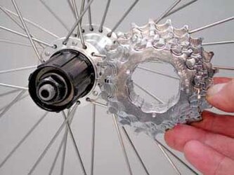

Same sort of prob.With my Spesh Secteur Elite.So bottom bracket got sorted first.Then the pedals fettled.It turned out to be the freewheel hub.Trouble is lbs is having probs getting one sent from Specialized.They have had the bike eight days now.It's the longest i have been away from it.And no idea when i might get it back.A suggestion was get a pair of new wheels.Anyway going out tomorrow on the Galaxy a slower ride to Boroughbridge.In all this lovely heat.
But i digress a creak is an annoying problem.But don't worry you will find it.But a may cost a few quid,while they go through eveything.But it's worth it.
