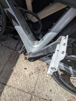

Getting a creak on every pass from bottom bracket are of bike.
If I don't push too hard it doesn't do it.
Is there anything I can tighten myself?
It's a 2021 trek emonda with Shimano 105.
It's not to long out from being serviced where it had a new cassette and chain.

These BB’s are cheap as chips imo. And I’m a stickler for weird noises / creaks. So I’d likely change it regardless ([Presuming crank arms, pedals and sprockets have been checked for tightness ?]. **And after that trying to feel for play / movement in BB.

It's not really a case of tightening something, but if you have the tools remove the cranks and the BB ,then clean the threads on both the frame and the bearing cups then lightly grease the threads and reassemble.
Creaks can also come from the seat post and saddle clamp, but seem like they are coming from the BB area.
Pedals are also great areas for creaks.
Good luck.

How do I tighten bottom bracket on this?
Can you tell from the picture?
I'll try the crank arm 1st.
