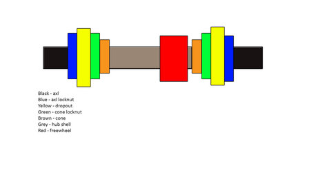

In the non-drive side there is a spacer of 6mm between the cone locknut and the cone. The spacer isn't in image.
Forgive me too for not understanding (maybe i'm wrong) : the photo is ok? If is ok, blue is in contact with yellow outside surfaces.
But, probably I make a mistake... :smile:

Having a spacer on the left side is normal. It's needed to keep the wheel on the centre line and if it wasn't there the difference in spoke tension between left and right would risk the left side almost losing all tension, which would not end well.
You have not answered the question I asked: "Does the wheel with an OLD is 124mm fit in the 130mm dropouts without a huge compression, applied when you tighten the nuts?" If not which dimension is wrong?
