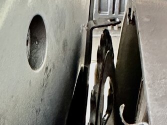

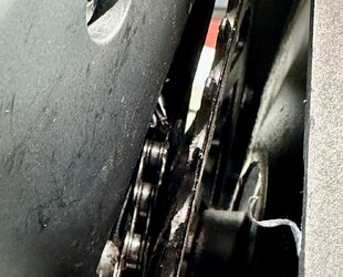

F**K, F**K, F**K!!!
Now the bikes broken. I was happily riding when I got that familiar event when the pedals stop turning and you know the chains come off. Irritating but hey that happens and easy enough to put back. No, not this time. The cassette is at the back but the chain was off at the front and wedged into what I assume is part of the motor. It looks like it’s now also wedged under a metal clip which holds the plastic cover in place.
I’ll take it back again to the dealership tomorrow but this is a bike that cost over £3000 last month and has covered just 116 miles!!! :angry:

I had the chain come off my Cube Reaction and get wedged similarly and was worried it was going to be a back to dealer job. I don't know if this is going to be the same for your bike but worth a try. As you know you can't move the chain by backpedalling as on a normal bike due to the ratchet in the motor gearbox. However I was able to unwedge mine by putting the bike on a stand and carefully moving the rear wheel backwards while teasing it up and out with fingers. Once unstuck i was able to get the chain back on the ring. I was worried about damage to the motor cover but it seemed to work without damage.

Thanks. I’d give that a try but as the bike‘s just a few weeks old and still under warranty I’ll let the dealer fix it.
