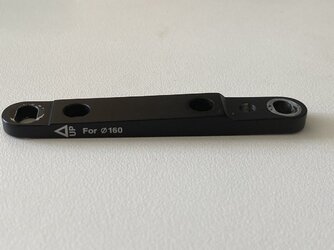

I happen to have a front adapter on my desk as I am converting from 140 to 160mm. They usually come with the calliper. For some reason the rear does not and costs about £15
