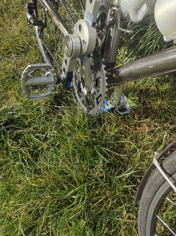

A couple of photos to demonstrate.
At the bottom of the pedal stroke (i.e. Leg fully extended), pedal in normal position:
At the top of the pedal stroke (i.e. Leg bend would be > 90 degrees without this), the crank is, in effect, about 70mm long (this is adjustable), meaning leg bend is well under 90 degrees):
There are 3 pedal mounting holes in the pendulum as supplied, I've shortened mine after deciding I only needed the one position.

Update!
I have recently discovered that unicycle cranks come in very short lengths and are available to fit square taper and ISIS* bottom brackets. This means that the clamp part of the Hase system isn’t required - the ‘pendulum’ part can be attached to the pedal hole on the short crank.
This reduces the Q factor and feels more natural. It also does away with the problem of getting the pedal absolutely square. As a side benefit I guess it also reduces the weight a bit.
*ISIS seems fairly common on E-Bikes, as pictured.
I've been looking for THIS solution, and didn't even know it. THX.

I too use this method as I use pendulum cranks on both sides. The q factor is large with the use of crank shortener+pendulum cranks on both sides. So I now use the left Fietsen pendulum crank attached to a left unicycle qu-AX 89mm square taper crank. Pity the right side still has to use the regular crank shortener+pendulum crank. One advantage of mid motor (excepting the Bosch Gen 3 motors which use BNI aka mini Isis) ebikes is that short unicycle cranks can be employed on both sides with the pendulum cranks directly attached to them.
