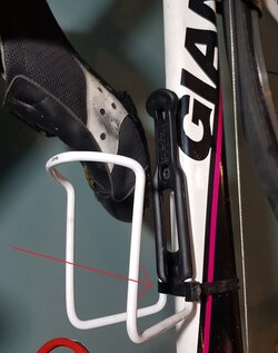

downtube thick
Marchrider
these tubes are made to be 'just strong enough' the thinnest material possible to save weight - drilling anything through it will create a weakness, and that weakness could be just too much - and remember aluminium can fail catastrophically
far better to make some sort of strap to go around the frame, 3d print something. far safer

No, I mean the top of the downtube. What has happened is that the lower vertebra has disappeared and its hole has widened. I have restrained it with a belt. Due to the widening of the hole, it is not possible to install the m5 size revnut. But with my research I found that Plusnut is a better option.
I assume you mean under the down tube ? i would be looking at a strap on model to save the potential problems
https://www.sjscycles.co.uk/bottles-cages/sks-anywhere-bottle-cage-adapter/
https://www.bike-discount.de/en/ibera-strap-on-bottle-cage-mount

You made a good point. ofcourse, I do not intend to create a new hole. But I want to use the main hole that has been widened. I have already restrained it with a strap. Maybe this will suffice.

If you really want to know the thickness of the tubes and don't want to cut them up to find out then you'll need an ultrasonic thickness gauge. You can buy them on Amazon but I have no idea how accurate they are as I've never used one.

these tubes are made to be 'just strong enough' the thinnest material possible to save weight - drilling anything through it will create a weakness, and that weakness could be just too much...
Yes that's exactly what many manufacturers do in order to provide mounting bosses on alloy frames.
