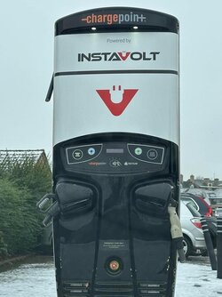

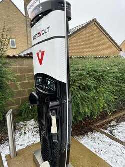

If you were relying on a fast charge at the Co-Op in Market Deeping, don’t… looks like someone’s been and cut/had all 4 cables. I hope this isn’t the start of a new trend for scrap metal bandits 😡
