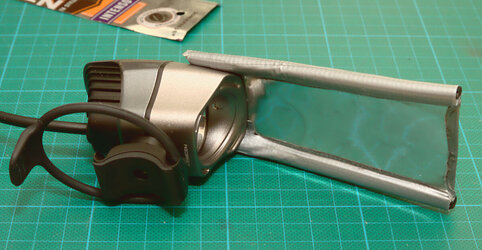

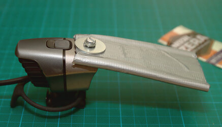

I bought the BT20 on 05/01/2014.
It had the lens with the fresnel panel at the top and was described as a shaped beam for cycling but imho, it was very poor. Bright but not a usefully shaped beam. Angled to illuminate enough road ahead and it was painfully dazzling to anyone coming the other way. Angled low enough so as not to dazzle others and it was stupidly bright just immediately in front of the bike (if that far ahead) and ruined any visibility beyond. I even tried modifying it with a large reflective "visor" (see attached pictures) but it was no good. I eventually replaced it in October 2015 with dynamo StVZO lighting and haven't regretted it - still using it today and still thinking it's great.
EDIT: I hasten to add that I am a big fan of Fenix torches, having bought them before the BT20 and since the BT20. Apart from their bike lights, I have high regard for the brand.
The BT10 and the BT20 were the first bike lights produced by Fenix - iirc, they were introduced at the same time as each other.
