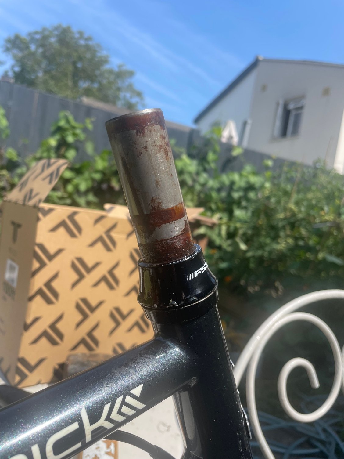

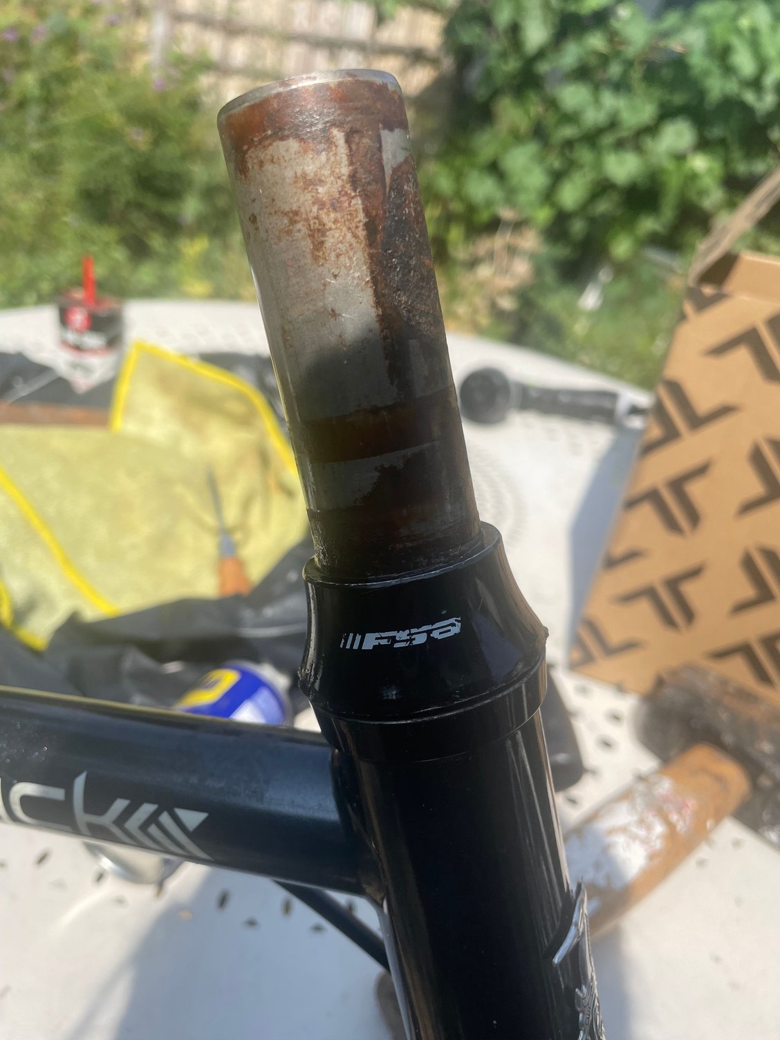

The handle bars would not turn so I am trying to take off the spacers so that I can detest the stem and headset. I have got most of them off apart from the last one which is seeming impossible!
in the process the wd-40 must’ve helped as the handle bars will twist now but not enough!
The spacer or compressor I am trying to remove

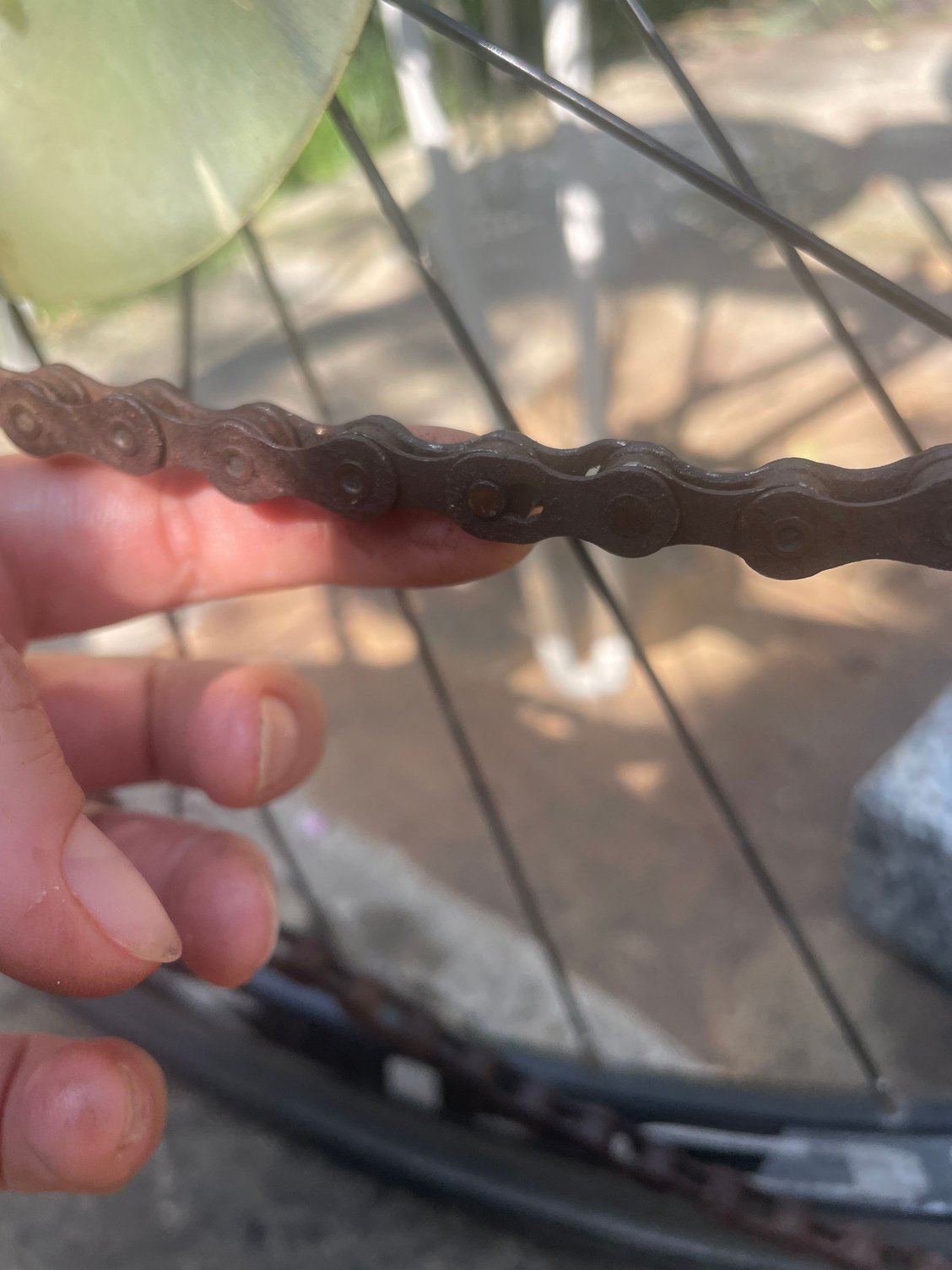

I am also trying to remove the chain so that I can derust it and see if it is in good enough condition after that!
it is a split link chain but I just cannot remove! I don’t have the tool to and don’t want to purchase one!

You'll need a chain tool to fit the new one as it will have to be cut to length. Forget about cleaning the chain that's on there, it's beyond redemption.

Regarding the headset, once you have removed the stem the fork should just slide off, the fact that it doesn't indicates that the compression ring under the top cap is possibly stuck due to corrosion. It will take some work and care to get the fork out without damaging anything. It s likely that you will need new bearings for the headset.

Okay thank you so much, and how do I work out what bearings I will need to buy?

With the best will in the world if you're going to buy 'project' bikes and not use a LBS to put things right then I hate to say it but you won't get very far without investing in a few proper tools. You might be able to bodge getting a quick link off but if you have any plans for getting a new chain you'll invariably need to remove a link or two to get the right length. You could try a hammer and suitable punch but risk damaging the chain irreparably. Take a look at the thread we've got for bike charities/ projects. If there's one near you if they're like the one I'm involved with they'll happily help you.
