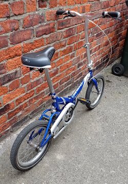

I have put my Folder Dawes Kingpin on BMX wheels, upped spokes from 28h to 36h (I am Lardy!!) The handlebars are to give me more range of 'upright/comfy' posture.
The little bike is a single speed folder, for SWMBO, and I'm changing the rear sprocket from 16T to 12T, getting the gearing a little less 'keystone cops' on the pedalling....
