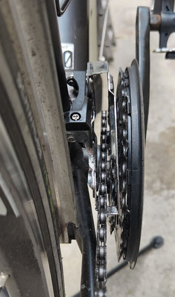

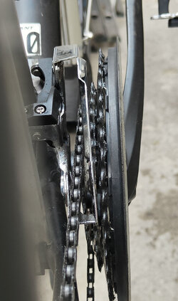

A car knocked me off my bike some weeks ago - lucky only scrapes and bruises and relief that I can fly through the air at 69-years-old and land on my back with such minimal damage. The front wheel was wrecked but due replacement anyway.
I've just noticed today that my front derailleur looks bent to my untrained eye but I thought I'd ask the gurus for their diagnosis. What do ye reckon, guru friends?

It does look like it is out of alignment. The plates should be more or less in line with the chainrings. Is it still shifting ok?
Is it a band on FD? If so you can loosen the clamp bolt and slowly move it back into position.
It's shifting but there's a trailing sound on the big chainring.
Shimano Deore LX FD-T670 10 Speed Front Gear Mech Derailleur Dual Pull 34.9mm​

I put the chain on the big ring and could see immediately that it was misaligned in reference to the outer guard.
Thanks very much for your tips.

If it is band on I suggest that you put the chain onto the small chainring and take out the tension on the cable before moving the derailleur. If you don`t you run the risk of moving the derailleur down as you move it into line. Then once tightened try it on the large chainring and check again. I know, I have done it.
