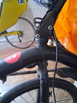

You might want to try putting an oring round the steerer fork inside the head tube. I’ll slow the steering down.
Thanks. Will look into it with lbs/bikefix.

Thanks for the input; the stem is fixed on this model, although it looks like it should move, it doesnt. I am not sure where the 'O' ring should be fitted, I shall have to ask my LBS to fit it as I wouldnt be able to do that myself; does it go above or below the frame?
