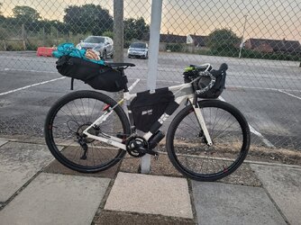

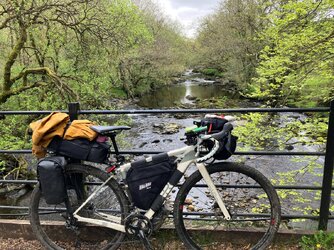

I've so far rode just under 2000 km of loaded touring on 1x equipped bikes and I can't say I've ever noticed a problem with gaps in the gearing, overall gear range though, that is an issue. Like I mentioned up thread, I did soon realise after my Slovenia trip that a 36 tooth chainring married to a 10 - 42 cassette was a little too much for my legs, so I now tour on a 28 tooth chainring married to the same cassette. This is a problem inherent to Gravel bikes though, without entering the realms of mullet drivetrains you are always going to struggle with the fact that the largest cog available on the back will be about 42 teeth, so by going to a 28 tooth chainring for the front, I'm sacrificing a little top speed for climbing ability which I think is a fair compromise.
In May I rode 130 km around the Harz mountains with a friend on a Canyon Grizl that was equipped with a GRX 2x drivetrain and it was interesting to compare. For the most part we were evenly matched neither of us struggling, though he was having to use his front shifter a lot to keep in an optimal gear. Uphill I was leaving him behind with my much lower climbing gear, but coming down the Brocken was the only time I really noticed a difference, on the tarmac he was averaging 55 kph and I was topping out at 48 kph. As soon as we hit the gravel downhill though we were both evenly matched and it was only our courage that was keeping us from going quicker.
The original post mentioned searching for a gravel bike that is also suitable for touring and 1x is going to be featuring a lot on modern gravel bikes. If that touring is predominately off-road then I really see no problem with using a 1x drivetrain. It all depends on the needs of the people looking for these bikes, I wouldn't be so quick to dismiss 1x though.
