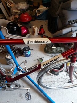

Yeah I've guessed that I've put it up for sale on this site hopefully I can shift it on as gravel biking isn't for me. I'm going to build my audax bike back up with the money and get back on the road
