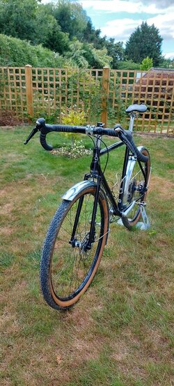

I've got a gravel bike/ touring bike but I fancy going back to audaxs but I think it wouldn't be rite with the large 47mm tyres and if I put say 32mm on there I think it would look odd with a massive gaping the folks.

I've got 650b wheels and I can't find any narrower than 40mm which I think is to big and tubless I've got on at the moment I'm not sure.
Depends on the tyres but there are some tyres that width in 650b just as quick a narrower tyres on 700c. A friend does audax on that kind of width 650b.
More to the point the funny handlebars would cause a few comments!!
