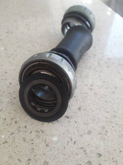

I'm in the learning curve still but my mtb bike had by feel and play a worn bb
So I exposed it to clean and replace/renew
First off I was taken aback how much grime was Inside the bike bb shell ...and how it got there
The drive side bearings seen smooth enough
The nds are terrible ...there was a good explanation to this from alex Bay I found in my first attempt to read up on this
I could not find what I was after so here we are and I'm after your informed help
Can i remove tbe fibre "washer" on drive side to expose the bearings anyways and replace ?
The nds bearings do not seem to have a fibre washer but a rubber 0 ring round it that is i asumes sealed by the flower washer between the bearing and the nds crank
This rubber seal seems very perished and I think the whole cartridge needs replaced ..
If the above is not possible then i don't mind buying an extractor to remove ( I'm not going to start making things up then hitting with a hammer )the whole cartridge and replace both
The new installation documents page from sram detail to press the bearings into the threaded cups so I again assume they will Indeed be able to be extracted and avoid having to buy 2 new cups with bearings pre installed
Just for info...along with the grime inside the bb there seemed a very distinct lack of grease etc

The wavy washer should be on the drive side if needed. If you are handy you can remove the bearings from the cups and replace. The bearing code is on the seal.
The top hat (plastic washer) on drive side can be removed. GXPs don't last too long if you don't grease them regularly by removing the seal. I replaced mine with a Praxis Works GXP, but even that, I've changed the enduro bearings. Mine is on a MTB so gets a hard life.
New bearings are about £10 a side with postage, so might be as cheap to replace the lot. Praxis are £35ish from memory.

I think I read all about this in a previous post from your good self on this
So if I prise off this top hat washer with a pick,,,can I re install this washer even though it had slight pick damage

Yes.
The top hat is just a spacer, behind it is the bearing. Pop the seal off with a pin or pick and regrease. You might benefit from removing the cup and flushing the crap out before regreasing. My top hat used to creep out towards the crank, so I installed a piece of 23mm road tube on first to keep it pressed in place.
You can get replacement bearings, but you may need a blind bearing puller (I have one) rather than drifting it out.
On my Praxis, the drive side just presses into the cup, the non drive side is pressed in place but has a circlip to retain it due to the design of the axel.

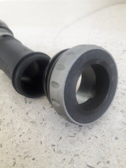

Now that I know bearings are available etc ( thanks fossyant )
I elected to remove tbe DS bearing ( all be it seemed in ok condition) and to replace
This proved really hard to get out with sliding hammer .in comparison to NDS which came out easy...ish
The DS is now out ...but I'm not experienced enough to say that the external cups are ok after this effort
Inside the bearing face are 3 uniform grooves that look like they were manufactured into the cups ( not defects from the slide hammer)
I know you cannot see them but do you guys know if cups are fragile or if they can take some abuse from a slide hammer to be re used
