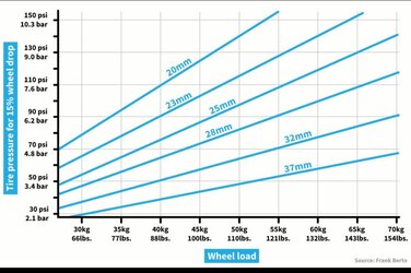

What PSI do you have in the 28mm tyres ?

presta
Yes, I thought the same, the seat also used to be tilted far forward. So the stem was swapped and the seat was tilted back, but it can only be tilted so it so far back before back pain starts.
See here.
What many don't seem to realise is that when you pick a riding position, and by that I mean pick a bike that dictates your riding position, you're also committing to the power output determined by that position, which is fine if you have the fitness to back it up, but if you don't it can be a recipe for hand problems as you support the excess weight on them.
You see a lot of advice along the lines of "You need to do this, because that's what the pro's do, and they're the experts", but the pro's are a lot fitter than most of us (and me in particular). I rode racing bikes for years, not because I was a racing cyclist, or even as fit as one, but because they were the fashion at the time when I started cycling. When I got my Horizon I was beginning to cotton on to the root of the problem, but I still hadn't looked at it in sufficient detail to enable me to get a more appropriate bike.
