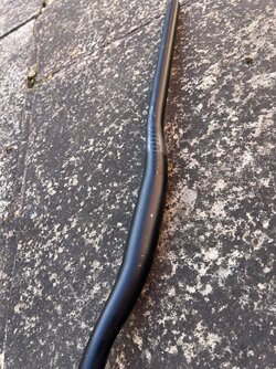

Well guys i was wondering if anyone might know something about steering bar that is fitted to Voodoo Bizango Pro 2023 . I got all serial numbers pictures etc and still can't find any same like my one . Mostly because i changing my steering bar i will appreciate if someone might know the price they going for .
MTB-AL-320BTF0V6
06AS H2022
MTB handlebar 31.8mm 720mm rise 20mm
N0bodyOfTheGoat
Hampshire, UK
31.8mm clamp diameter (where stem clamps around bar) is a common standard.
If 720mm width and 20mm rise was comfortable for you, choose your preferred bar material and search away at your budget.
vickster
Don't need the same brand, just do a Google search on ... MTB handlebar 31.8mm 720mm rise 20mm and see what suits your needs/budget as above. I would definitely avoid anything carbon from the likes of Shein/Temu as you'll have no idea of the quality/safety checks done (if any were)! 720mm width seems a bit harder to find than 700mm, do you really need the extra cm on each end?

I was about to say that handlebars are one area where I don't buy the cheapest, or battered secondhand.
They are a safety critical item.
MTB-AL-320BTF0V6
06AS H2022
That's an OEM handlebar that comes stock on the bike. You generally can't buy it separately from Voodoo. Your best bet is to check eBay or Pinkbike for someone selling a take-off bar from the same model bike. Otherwise, just buy a new aftermarket bar with the specs you like.
