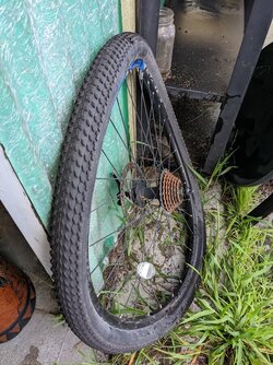

Yeah Chris. I was thinking that or trying to replace the new cassette with the old one. But I imagine replacing the cassette would take more time and effort, since I would probably need the specialized tool/s. Plus the damaged old wheel has been out in the elements.
ChrisEyles
Devon
The 7 speed cluster of sprockets on your old wheel looks like it's a freewheel (ie pawls & bearings located inside the sprocket cluster, which then screws onto a threaded hub).
The new 8 speed one you have will be a cassette (ie slides onto a splined freehub on the wheel, with the pawls/ bearings located on the wheel freehub rather than inside the sprocket cluster).
They're not cross compatible I'm afraid - the good news is the cassette / freehub set up you now have is a better option than the older freewheel system.
If it were me, I'd get hold of an 8 speed shifter for the rear mech and keep everything else the same. That's probably going to be cheaper than buying a new 7 speed cassette (which are a bit niche, cassettes came in at around the same time as 8 speed so most cassettes are 8+ speed).
This also means you won't have to buy a chain whip and cassette removal tool (though these are great to have for long term maintenance and will save money in the long run vs going to a bike shop).
