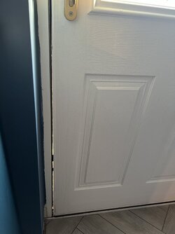

I’ve noticed my side door is draughty. When it’s sunny you can see the day light through the gaps. Here is a picture, should I buy a better door & frame?

Eh, yip.
There may be an insulation strip missing but most modern doors close in a half lap to avoid such a poor example like you have.
Looks like a botched job to me, being honest.

Quite dreadful
lost somewhere
If the door and frame aren't warped, you can get it fixed. Brush seals are not very effective. I would use external rubber seals to keep draughts out but you need to choose the right type.
