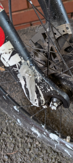

My clunker bike has front sus, it's covered about 35k with no attention however the lockout failed last year and this happened a few weeks ago.....
I don't think it has been hit, I suspect it's failed inside out.
So it's probably time for something new, well, a replacement .
