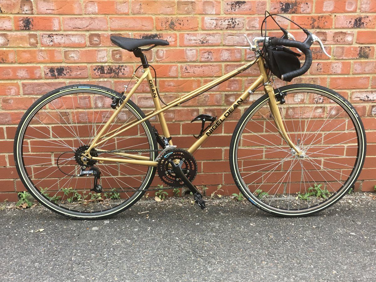

Mrs Spesh has a lovely vintage Nigel Dean which she's ridden on a couple of bumpy Eroicas without any issue whatsoever. Occasionally I will plonk my 80kg on it and take it for a ride, again without issue.
