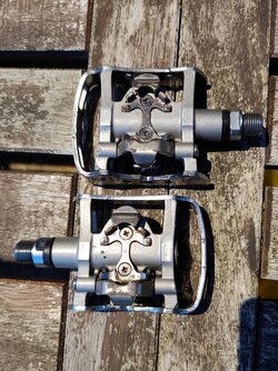

I've got some "dual-function" pedals knocking around from a second-hand bike purchase (I've never ridden clipless, so at the time I replaced them with standard two-sided flat pedals).
As my current pedals are wearing out, I'm wondering if I can make use of these dual-function ones -- in particular, whether I ought to give clipless a try. So, could anyone identify what sort of connection these are, and what shoes I'd need to look for? They're Shimano branded, but I can't see any other info.
Thanks in advance!

Shimano mountain bike shoes and two bolt style cleats and you are away. The system has not changed in years, and your pedals will be fully compatible.

Yes, those are PD-M324. I bought a pair recently. Installed them for a while and then took them off. Nothing wrong with them, just a change of mind. They're good pedals, pretty much the "bog-standard" dual sided Shimanos, been around for ages.
The two pairs of shoes I use are:
https://www.spacycles.co.uk/m6b79s154p3382/EXUSTAR-Stelvio-SP-705-SPD-Shoes
and for a more "non-cycling shoe" look, these:
https://fawkes-cycles.co.uk/shimano-clothing-shimano-ge5-ge500-shoes-sand-beige-p34537
Both shoes worked well with the PD-M324, using these cleats:
https://www.tweekscycles.com/shimano-sh56-multi-release-spd-mtb-cleats-madsmsh56/
By the way, both those shoes worked fine on both sides of the pedals, the SPD side and the "flat" side (the side without the clip). Though worth remembering that as SPD shoes have a hole in the middle, where the clip goes, there's less sole surface to grip the pedal, if you're putting them on the non SPD side of the pedal. The GE5s especially have a very long section in the middle with no tread.
In terms of walking around off the bike, both shoes work, though there is a slight crunchiness from the Exustars on paving stones/tarmac. The GE5s don't have that, and in fact were fine for a march around a city in the rain yesterday. I barely knew I wasn't wearing ordinary shoes.
