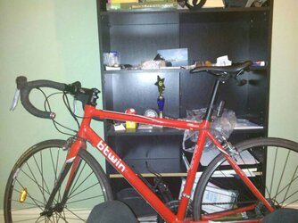

It's more likely that the saddle is tipped up too much at the front. Are you able to post a side on shot of the bike?

I am 14 stone, so pretty heavy. Mostly because of my height and build.
This is the best photo i could get. The saddle as a whole does seem level, but it has a shape that means it rises near the front (why??).
I just adjusted it slightly to make it properly level. Hopefully problem solved, otherwise I'll need a new saddle.
