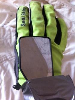

When I said that bar-end mirrors would stick out, I meant if they were the same size as what you could comfortably fit onto the back of your hand.
sorry but no - here is the zefal dooback I use on my flat/moustache bars and have done for 15+ years. the part taped up is the bar joint bit, kit is lying flat & crossways here but in position on the bike it adds 1 cm width to the open mirror. Like I said before, if that is clipping a vehicle when I'm riding then there's a serious problem about to happen.
I couldn't fix it at both ends and still get the glove on, I tried when already in the glove and could not flex my fingers far enough to brake or click a gear. I suspect gripshift would be impossible in it too. it is a slight convex mirror and I inclined it in the same manner as it would be when bar ended, yet it was damn near impossible to get a rearward view at all, it took a quite painful contortion and as above zero context to frame what I am seeing in there in such a way as to be safe trusting my manouvre (life) to it.
smaller mirror length (flat, from a make up compact)
taped 1/2 cm either end to hold it in place
My hands are entirely normal size for a 5'10" tall bloke and even that relatively small mirror was impossible to manouvre into and out of comfortably with the same issues around flexibility at the wrist and digits and uncontextualised rearward image, being flat the issues of being impossible to see anything in were even greater, I would have to break bones and tendons or be deformed to see out of it. It is far less manipulatable than armoured motorcycle gloves, which is the nearest comparison I can think of.
It is a non starter. you'd need a fixed point, control of the bike, a natural body flow and not just peripheral vision constantly and immediately available to you front and rearward facing. Your plan has none of these. Also from comments here and elsewhere whenever mirrors crop up, I'd say approx 90-95% of riders think they are stupid and/or useless and would not even consider the idea let alone spoil the line of a bike with one, the other 5-10% or so that do 'get' the benefits have already found that the options out there that work and don't need reinventing.
I've knocked up a quick couple of prototypes, am giving you years of experience of daily perfectly happy and safe mirror use. I've years of trial and error with dozens of the things and even the worst were far better than what I taped to my gloves.
I'm not being unkind but you need someone to highlight in practice the glaring holes in something you've done a 2D drawing of and no disrespect but you really don't come across as a bike mirror user nor having any sort of understanding of how differentially moving objects interact in a mirror.
